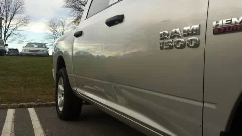

Yesterday on my way to work, a deer ran into the side of my 3 month old truck and now this.

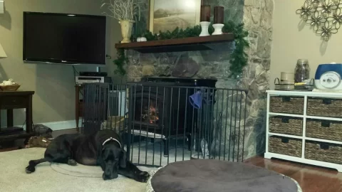

New glass installed and back up and running!
Excellent, I would want to turn the stove off either with that dawg over there..lol, Back in September my sister had her van totaled in NC also, she was hit head on, thankfully her, my brother in law and the kids had very minor injuries. Sounds like NC is a rough place to drive for us NJ'ers
