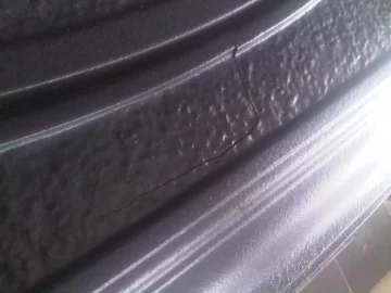

The top of my Oslo cracked Friday evening. The Oslo had been cruising at around 500 degrees when we heard a metallic pop. A closer look showed a crack on top of the stove. The stove is less than a year old. I contacted the dealer and the top will be replaced, so no worries there. I am still wondering what may have caused a newish stove to crack like this. Thoughts?
Being an Oslo owner I am very surprized at this! Can you share a photo?
Love my Oslo! :)
I would be curious to here a little about how you burn the stove. I have seen 2 cracked tops over the years and one was a kettle that over flowed on the top causing the crack. The other one the owner dropped a lead weight of his mantle on it. So to say its rare is an understatement.
Could of been a bad caste. 500 should not of cracked it.
Samoyed; first we welcome you; keep us informed and yes pictures; we try to help each other with issues so good luck and keep us informed.
I think this is the first report of a cracked lid on a new Jotul here. Sounds like a defective casting. Good to hear that the dealer responded quickly.

We basically learned how to burn from this site. We usually let the temperature rise to somewhere around 550 then turn down the air and let the stove cruise until the next reload. Our wood is good (thanks to this forum). We are not doing anything "special". Chimney works well. We did not drop anything on it.
We love our stove. We find that it provides lots of heat, is easy to use and importantly for my wife, it is "pretty". We have the blue/black finish.

A picture would be nice, it may be that there was some stress built up that relieved itself out from a corner or something..

Where do you have the stove thermometer located on the stove?

As thick and heavy as those Jotul top plates are it had to be an impurity in the casting that finally popped.
Better late than never ...
Dealer + Jotul took care of us ... so no worries there but for your entertainment ...

Wow. That's an interesting crack.
Wow! By chance, was the insulation blanket removed from above the baffle? That's one heck of a crack.

- new stove
- no modifications
- professional install
- burn by the book
Everyone involved (dealer, installer, Jotul, ..., us) was very surprised.

Odd place and very odd way for a piece like that to crack, glad you had/got good support.
