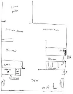

Ok so it is time to pull the trigger and I need to decide between a Jotul 500 or 400. I have received differing points from dealers on the size. Here are the particulars....
Live in Central ma. Downstairs is about 1700 square feet...upstairs smaller. (attached a very crude layout.)
I have a pellet stove in the middle of the downstairs but with the cost of pellets do not use it much...mostly at night to keep the boiler off.
Upstairs is electric but we don't use it very often. House is not very tight..older windows etc.
The room the stove will go in is on a slab...and there is a picture window, sliders and two other large windows...is it a pretty cold room.
Hope to heat as much as the downstairs and get as much heat upstairs as possible.
So am I better off going bigger? Price difference is only about $200 but dont want to blow myself out of the room...as that is where the BIG TV is....where I spend most of my time.
Your help and input is appreciated...as always.

If the goal is to heat the most of the downstairs, the stove should be placed there. From the picture it looks like ideally that would be somewhere along the wing wall between the living room and the kitchen. I'm curious about the enclosed space behind that wall. Was there an old chimney in there?
Was the den at some point a porch that got enclosed? If so, it could be leaking heat badly and the slab can suck the warmth out of you. With all the glass in it, I can imagine this being a pretty cold space. It looks like a lot of heat will be lost and what gets into the house may be less than optimal. For those reasons, I'd go with the Oslo. Make sure there is room to cover its side clearance requirements. It needs extra on the left side for the door.
The "ideal space" is where the pellet stove is now...but it is just about cheaper to burn oil at this point. Hopefully the cost of pellets will come down
The area is not an old porch but an addition.

The choice depends on the lifestyle. If the den is an occasional space, then maybe move the pellet stove to there and locate the woodstove in the core of the house? If the den is the main hangout, then a woodstove will be much appreciated in there. It will contribute to the house heat, but will mostly heat the den.
