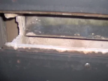

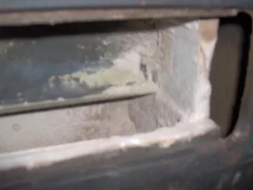

Thank-you for your reply's, Browning and NonProphet - I found an old thread that name a product called Fiberfrax which is 20.00 or so per tube it is a moldable product that will stand 2300 deg fer. I have the piece that broke off and I was going to try the repair to just get me by for this season. The way it broke off I should be able to smear some of this product on and hold it in place with a couple nails, then I was going to form a small bead along the three edges on the inside and let it set up. I know this will be a temp fix, I was just curious to know if you think this may be worth a try.
Thank you both for your time and I will let you know if it is a successful repair.
