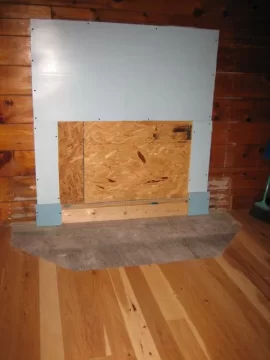

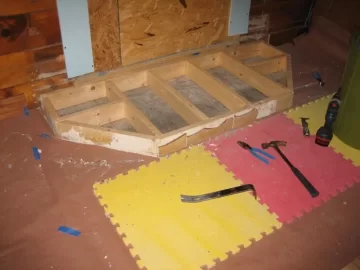

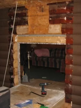

So I broke down and destroyed my original hearth. Now I realize why my butt got so cold sitting on this old hearth. No insulation and just a 2x6 separating it from outside.
I was hoping to put a Jotul F400 on this hearth without having to make it any bigger, but no dice. Here is the new plan. Please comment if you feel I am doing something wrong.
I am going to build a new wall directly behind the log wall out of steel 2x6s and Durock and insulate it well. This will make a small alcove that is the same depth as the logs, so about 7-8 inches deep, 48" wide, and 48" tall. The stove will not sit in this alcove, though. The back of the stove will be in line with the log wall, with 7-8 inches of space behind it. The side clearances will over 10" on each side to the corner of the alcove. The new hearth will be built out of steel 2x6s, as well, and will be 40 inches from the back of the small alcove. This gives me the 16 inches that I need in front.
I believe I will not have to worry about the clearance to the ceiling of the alcove because the stove will be in front of the actual alcove and I am going to slant the top 7-8 inches of it at a 45 degree angle. Then a stone mantle 10 inches above that.
The entire alcove will be non-combustible: steel studs, Roxul insulation, and El Dorado stone and/or brick veneer. Thanks for any help I appreciate it.
The pictures are of the original Majestic pre-fab, the hole in the exterior log wall, and the destroyed hearth.
