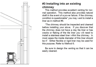

    Check out the Selkirk DT chimney kit (called Masonry conversion kit) with the built in OAK. it works with your 4" liner, I have one and there is nothing better.
    The vacuum cleanout is cool too!

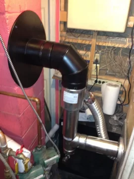

    I have my Harman XXV vented into an 8" clay lined chimney flue I had used for a wood stove. The XXV manual stated this could be done, the dealer gave the OK, and the building inspector said no problem. It's been operating with this chimney for 2 years now. Check the manual for your stove as well as ask the dealer and building inspector to see if the existing flue would be appropriate.
