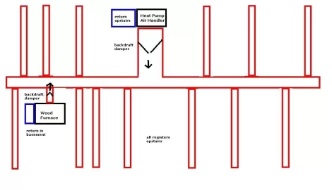

    I'd like to resurrect this thread as I'm planning something similar. Take a look at this pic. All duct, air handler and wood furnace are in the unfinished basement. All registers are upstairs. The wood furnace and air handler are probably 20ft apart. I know this isn't optimal, but would it work? I don't want to run the wood furnace supply over to the air handler plenum because I'd have to drop below the floor trusses to do it.

    Like the OP's system, you will get much better performance by insulating the basement. The heat loss to the walls and via the ductwork (if also uninsulated) will be major.
    What size is the trunk duct where you want to connect? Usually it is downsized quite a bit from the core plenum. This helps balance air flow to the end of the line registers, but it may work against this setup by trying to feed from the end instead of from the center.
    In theory the set up will work, somewhat. What I suspect will be the down side is that the opposite trunk will be underfed resulting in that end of the house being cooler. It could be improved by not returning air from the basement, but instead ducting the furnace return up to a floor register on the main floor of the house.

    Sorry, I should have clarified. My basement is well insulated...as is the whole house...new construction. I just want to supplement my electric heat pump during the coldest months.
    The trunk is 14" where I connect (the englander output is 8"). I'm sure the other side of the house will be underfed, but I have a 10" duct booster fan I could use as well.
    My main concern was when (if) both the wood furnace and heat pump are running, would the 2 sources to the same trunk cause any issues? ... other than less than max efficiency.

    I definitely would set it up so that they can't run at the same time. It would be bad if either system's pressure kept the other's backdraft damper closed while in operation.
