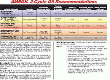

    I also found this page from AMSOIL on their different two-stroke oils - with ratings and application reccomendations... They have a chart with different applications - it says the TCW-III oils are reccomended for boats, and are OK for bikes, but are NOT reccomended for chainsaws and other OPE uses...
    My feeling on Bigg_Redd's statement
    is that he is probably right that getting ratings is expensive, it should be less expensive to run one oil through the tests rather than having to make multiple formulations to get tested seperately - each rating has several parts, and in many cases the results from one part can be used in other ratings, for a lower total cost... Judging from that Amsoil page, they seem to find it necessary to make multiple formulas for different applications.... I'm not saying that TCW-III is bad oil, just that it's not the right oil for a chainsaw, and IMHO it's worth the money / hassles to use the right oil...

    Welp, I use Amsoil Dominator at 50:1 so I guess I'm okay. The chart says Saber 100:1 is best for chainsaws. My racing buddy, who owns a motorcycle shop, has been running Saber 100:1 in his bike for 2+ years with good results. I still cain't bring myself to run it. He says the other Amsoils can be run at 100:1 but if they print it on the label noone will buy it 'cuz they're like me, old school. My race buddy is 10 yrs. older so I have no excuse for my stubbornness.
    If you ever come back mr2, sorry for the hijack.
