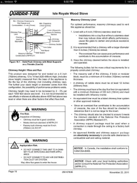

    One thing that really surprised me is that in the manual for the Isle Royale it actually states that the stove was designed and tested to operate on 12-14' of chimney... Measured from the base of the stove! Made me feel better about my 15' chimney, which I guess is actually 17' according to them. Still seems odd that they actually designed and tested it that low... Unless the top load feature opted them to design it to work with even the minimal amount of draft. I'm sure a couple of feet more won't hurt.
