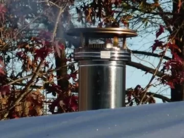

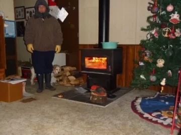

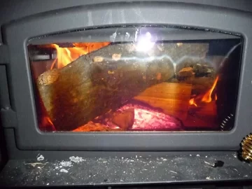

Happy New Year all. BeGreen, here are a couple pics. they were taken shortly after the install and the fire is with bad wood. the stove however is terrific. like mxjamie, i would like longer burntimes, but the benefit is that the stove is really a wood miser. after a good fire, thick bed of coals will restart quick if small starter wood is used first; for me, this easy start has been as far out as 36 hrs from shut-down (intake and output dampers closed). i would recommend this stove to others.
glad to have it on these 14 degree nights in Georgia. what the heck is goin' on? :roll:

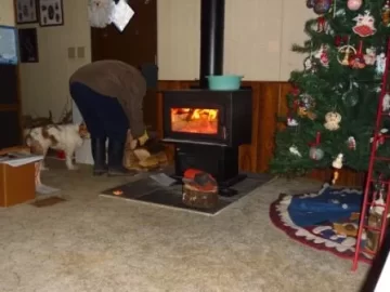

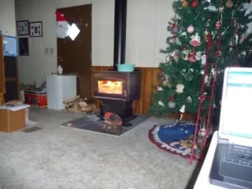

this is the fire right now. that's Linda, my wife bringing in some wood. she doesn't work tonight; i do. note the top damper is completely closed and the bottom (intake damper) is partially closed. i carefully and slowly use the intake damper (slightly closing it as tolerated by the fire) for control when the fire is hot enough that the exhaust damper is tolerated completely closed. this combination really allows for alot of air flow control, maximum box heat, minimal heat loss in the chimney, and a complete burn of the wood.
p.s. my wife is fussing cause she's all bundled up for the pic and i'm gonna post her on the net here anyway. LOL :) Its headed for 16 degrees outside and i'm sitting here with no shirt on and about to sweat.
life is good and ya'll stay warm.
