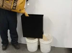

    Do a search for corn or pellet sifter. There are DIY plans for both the gravity type and the vacuum assist type. I use a hybrid gravity style with a vacuum port on the side for the real fine dust.
    Picture is of the gravity type as sold by Englander.

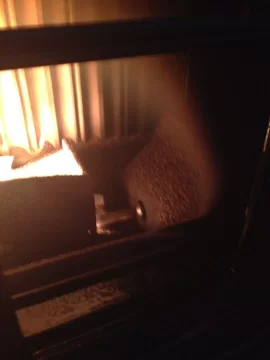

    So now that I think I have my (Vaccuum dust problem solved) I am concerned about excess dust, fines in my stove. See pic! Not having seen many insides of stoves other than mine...any comment on this build up? I said this was after 6 days but it is really two days.....and I have never screened/filtered any pellets and I do have lots of pellet dust in my hopper.... image.jpg *****Sorry if blurry, I can take more pics

    *****I want to build the above sifter as I use softwood pellets and I do have visible dust/fines in my hopper....BUT stove/auger run fine. I understand the benefit of the sifter...to keep the auger from jamming/caking up..... But if I don't have any auger problem is there any other reason, benefit to reduce the fines that drop in from the auger? Don't they just combust? ( is that a word?) I think I have a fair amount of ash build-up on the lower sides, L & R of the agitator but I don't know how much is normal or excessive? ***as for my dust problem, I think it is all coming from my shop vac and it's tell I got a real ash vac! Bottom line, I don't want to build and sift unless there is areal benefit other than preventing auger jams! Thanks, Bill
