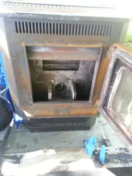

Hi did you give it a complete cleaning behind the steel plate that sits above your burnpot? You will need a leaf blower or a good shop vac with small tubing to get down in there to get it completely cleaned out from behind there as lots of ash that settles down behind there. Pic to show opening in back get in there give good cleaning top and bottom.
