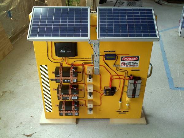

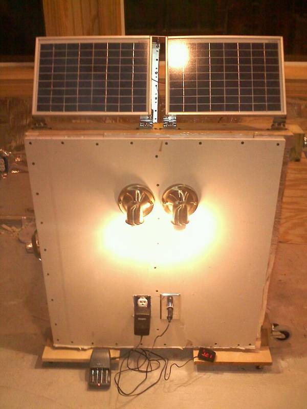

    DC has no power factor, which is one of the things that makes it more efficient. All of the energy is always 100% available. The other is that if you're producing energy via solar, it's already DC, so converting it to AC has significant losses. An LED is a diode, which means that it only allows electricity to pass in one direction. You can't have a single AC LED without losing half the power, but you could build a multi-LED bridge rectifier to get nearly 100% out of it.
    I built a small off-grid solar demo system recently which compares an AC vs DC LED bulb side-by-side. Both bulbs were rated at 4W nominal. The DC bulb used about 3.5W, the AC bulb used 12W as measured at the batteries. So clearly, DC is preferable where it makes sense.
