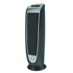

    I bought some of those tower heaters and I hate the things. They have a thermostat on them but since it is on the heater they are way off from the room temp. And I have plug in thermostats that I love but they won't work with the towers because they turn the power to the heater on and off and when the power is turned back on to the tower you have to hit the start button.
    They are wrapped in plastic wrap on a shelf in the basement.

    I picked up one of these:
    http://www.lowes.com/pd_100813-3345...l=1&currentURL=?Ntt=%22de+longhi%22&facetInfo=
    Got it running and plugged into my kill o watt meter, and it looks like it will cost appx 20 cents a day to run while I am home. (current rates are $.144 kwh)
    Would be interested to hear how you like your unit.
