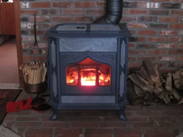

My wife and I love the Fireview - it's like having and open fireplace in our family room!
Welcome to the forums, great looking install you have there. I had some creosote problems this year and I think part of the problem was watching cat and flue temps, and engaging too soon. I also changed my setup over to top vent to get a little better draft so my cat probe isn't there anymore. I may install a thermocouple probe through the rear of the stove which would be much more accurate than the Condar probes.

Nice-looking install! Looks like you have the metallic blue also. Mine doesn't look too blue but I sure like that color.
