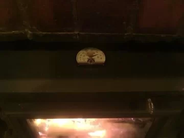

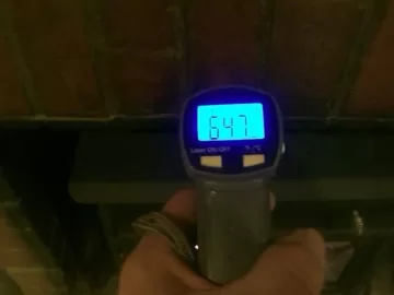

    I didn't really want to overfire, so I shut it down right after these pics were taken. Infrared agrees pretty closely with the thermometer. I need to double check the one on the Flue, though, because It was pegged even though the IR didn't read near that high. That stinks, because of the data chart I made earlier, although I guess it would mean that the heat was staying in the stove more than the numbers read instead of all going up the chimney. Oh well...
    Hottest spot seemed to be more like a third of the way from the left of the stove (as you face it) and mid distance between the stack and the stove front. We are talking like 20-30 degrees warmer than other places, so no biggie.

    When I let it rip like that i wasn't paying attention to the pipe, then I look at the sucker and it was off the gauge markings. I got kinda scared for a second, that's when I decided to put the IR to it. I'm just sure that the thing reads right at lower temps, so maybe it just isn't very consistent as the temps get extreme. I'll have to keep my eye on it now that I have this IR thermometer.

    Those IR guns are funny sometimes. If you aim at the pipe and you're not on center the reading gets lower. Try it. Hit it dead center then then veer left or right. My gun doesn't like to read things on an angled. My experience anyway.
