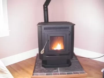

Hi, I have an Englander also and my hearth pad barely gets warm so I think you are safe.

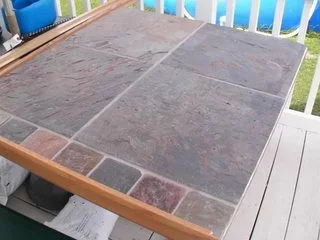

I actually spent around $80-90 on the material and built it myself.
sheet of plywood
some kind of heat resistant board that tile will stick to (forget the name)
on sale slate tiles
pre-mixed grout
finish boards around the sides
