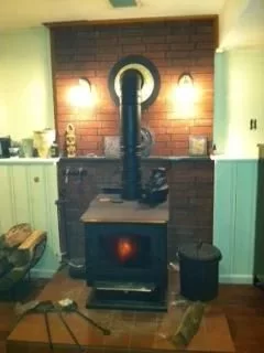

Here is a pic of the internal setup.

cmonSTART said:
Is the screen on your chimney cap clogged? Common problem this time of year..
I just had a sweep a few weeks ago. I will climb up saturday and double check. thanks.
that glass is showing that the stove is being burned too cool.
