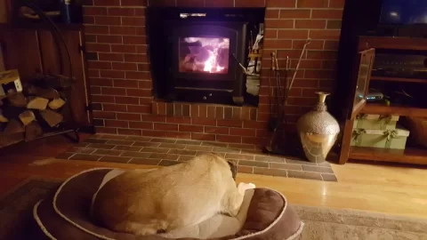

I chopped mine off so the ash pan sits about an inch off the ground and slid it into my fireplace.
Works great.
