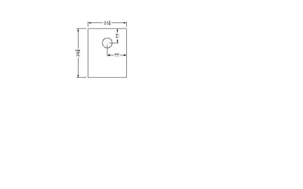

    Can someone with an Englander NC-30 give me all the dimensions of the stove
    web site says 23 1/4"w x 29 3/4" h x 31" d
    would you verify this footprint ?
    I also need to know where the 6" flue opening is on this foot print
    i tried to attach a sketch but don't know if its gonna make it.
    I want to see if my hearth is big enough for the NC-30?
    also want to know if this stove likes N/S loading and what length log will fit N/S

    On the pedestal base:
    28" high, or 29 1/2" high to top of the rear heat shield
    24" wide
    31" deep
    Opening for flue is 4 1/2" in from the back of the heat shield

    Oops. You also asked about N/S loading...
    Yes, it likes N/S loading. And so do I. I am getting splits up to about 20" in there N/S. Same as E/W...

    what's the width and depth of the firebox. I'm not finding that reference online, either.

    Danno,
    Didn't see your question...
    Depth is 20" to the metal framework around the door, 22" to the glass.
    Width looks like 19.75" firebrick to firebrick.
    And height about 9" to top of firebrick, 10" if you cheat a bit.
