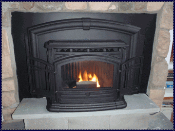

    Am a newbie. After struggling for several months w/ dealer(s) to agree to install unit into existing LENNOX pre-fab, finally just got an ENVIRO M55 insert installed yesterday (see attached image - support under stove was my handy-work) without modifying existing fireplace! Burned for better part of the day & night! Am very pleased... so far w/ investment!

    I am by no means an 'expert' in this area, however we just purchased an Enviro M55 2 weeks ago. We went through a lot of pellets (almost 1-40lb bag per day) until we installed our wireless thermostat. Now, we are still on the same bag of pellets from Monday. We keep our house cool 65-68 and it has not been too cold (30's-60's) we live on the Eastern Shore in MD, so our weather is crazy now. But I have noticed the we are burning a significantly less amount of pellets with the thermostat. ALSO....our dealer said to set the fuel type to standard for the best burn-even if you are using premium pellets. I am still not educated on why to do some things, but those 2 changes have made a big difference so far. BTW, your stove looks beautiful!
    Katie
