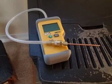

    OK got my manometer and spent the entire am looking for a piece of tubing or something to fit the test hole No Luck. It is an 1/8" hole.
    Will check auto parts store for 1/8 od copper tubing, and some hobby stores.
    Another Q. The air being drawn in at the bottom of the glass is the air wash. How much being drawn in is to much? I can feel a good draw placing my hand at the bottom of the glass.
    Any ideas.
    Bob

    If high temp not an issue try aquarium supply. Fuel supply lines for gas powered planes and cars

    Disregard the glass Q. When the stove is burning there is very little air being drawn at the bottom of the glass. I was checking during cool down, as soon as the glass heats up all is good.
    Just pressing the Mag tube up to the test hole I find that I need to close the damp down quite a bit to get down to the .12wc they call for. Had to clean out the damp slide to close it enough after 6 years of running what I thought looked good. I have been running at .20. Wonder what changes we will see with the new setting.

    Auto oil gauge hookup kit had the 1/8 tubing and fitting that fits on the end of gauge tube fitting.

    Thanks for putting the oil gauge hookup info out there. You just saved me some time i am sure. I got the same meter today and I am going to set the stove properly tonight.
    Out of curiosity, any noticible differences when you brought the wc from .2 down to .12?

    Yes I notice a difference. The ash on the window is a lighter gray and not as much of it. A lot less ash in the bottom bin and it is a lighter color than before and it sounds crazy but I think it is putting out more heat. Probably was not getting a full burn of the pellets the other way. Money well spent.
