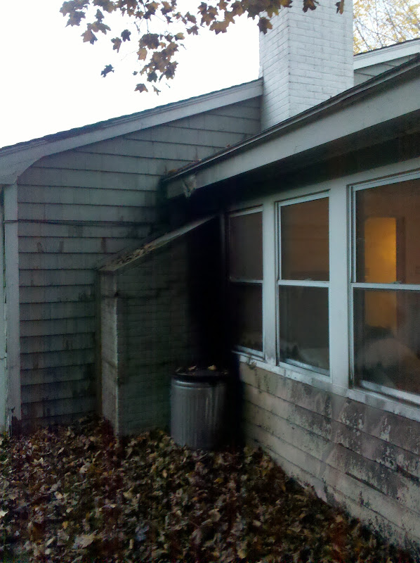

    I hear about this guy all over the place. His name is Carl. He works for a few hearth shops in my area and does some freelance pellet stove cleaning/ repair. I have yet to find one of his installations that do not have to be redone, but this one takes the cake.
    So 6 years ago he installed this stove. Exhaust is not high enough off the ground. Notice the black and charred remains of the siding and trim. Well, the leaves caught fire...because the exhaust is not high enough off the ground. Nor is the exhaust far enough away from the windows...but that is another story.
    The homeowner's leaves and yard catches fire and it singes the house, burns the roof, breaks the glass etc...
    So...they call Carl back and say. "what's up? this needs to be installed better."

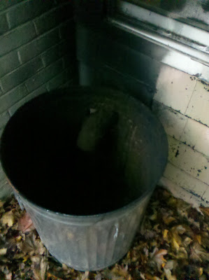

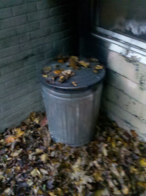

    The solution? He cut a hole into a trash can and exhausted into that. Homeowner says it's great, they keep the lid tight and empty the ashes once a year, but they cannot figure out why the glass on the stove is always turning black.

    And they ask us why we drink Lord. They ask us why we drink. !!!

    And the fire dept allows this why?

    You should never assume that the fire department (or town, whatever) evens knows about it.

    If I hadn't seen the picture Scott I would have thought you were making it up! At first I couldn't see the exhaust pipe and wondered about the blackened area.
    The sad part is that sooner or later he is going to get somebody killed.
    I wonder what the homeowner will think of Carl after seeing how you re-do the install and his stove works so well.

    This is a serious safety issue.
    I would call the fire marshall and report this guy to get him fired.

    Well I guess if the fire dept wasn't notified, neither was their homeowners insurance company. Lucky they still have a house and no one was hurt.

    I have seen the old spark bucket before, But always thought some verticle pipe would have been a better/safer option!
    No I am not carl! :p
    Shouldn't the spark bucket have a relieve hole or holes?

    Genius> Put 10 gal H2O in can to absorb heat n' soot. Cover side of building with aluminum foil. Pull off in spring, duh. :)

    What I find most amusing is that this is the SOLUTION the guy came up AFTER the house already caught fire once. One would think that after the house catches fire you find SOMEONE ELSE to create a solution and maybe even go a little over board with that solution. WHY they didn't just vent into the chimney which is 4 inches away from the stove is beyond me. Crazy stuff. Crazy.
