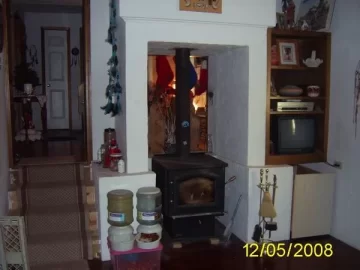

I have a quad 4100i. And this thing is a smoke puker.
Everytime the door is opened, I get smoke in the room. My draft is great, and the chimney is clean....I can't figure it out!

Is the upstairs stove running when this happens? Could it be there is negative pressure in the basement?
If your chimney is clean and you have a good draft there may be something to that negative pressure thing.
It's against code to run 2 stoves in the same flu here but back 30 years ago we did anyway and they both ran fine. But at the time you could see daylight threw our field stone foundation. Perhaps you could try cracking a window where the quad 4100i is running and observe any changes in the draft? Good luck and Merry Christmas.

^Next time the stove goes cold look right above the door and be sure that fire proof fiber board is pushed all the way forward (toward the back of the stove as possible). If you took that out for cleaning perhaps it isn't replaced correctly. Ehh!... worth a look anyway since that smoke leak has to be locked down somehow.
