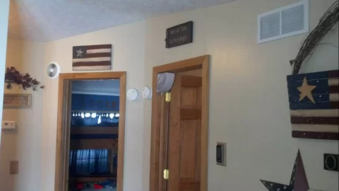

We used them up until this year. Added Broan and Tjernlund Aireshare through the wall fans. My favorite corner fan was a "Minuteman" model. Had a High and Low selection for speed and came with 2 mounting brackets. So you could use the fan in 2 different spaces. Also was reversible. Just put it in whatever direction you want (blowing hot air in, or out).
The Entreeair model is still hanging in our bedroom doorway. Although we dont use it, it still sits. It was Loud.... Yes, but it did work.
You can see the vent for the Aiireshare in the upper right corner, then the Broan to the left. I still use the Minuteman model for the basement door. To help pull hot air up...
They do work imacman. They probably dont pull the CFM's stated. But they are better than nothing. And the noise .... Well, it grows on you. Just like the stove noises. You get used to it. IMO

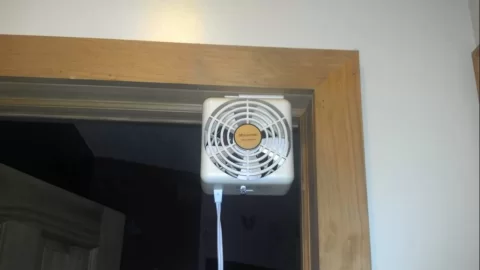

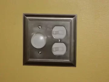

Hello Imacman
Is it like mine? See Below.
My fan is hooked up to a Line Voltage Thermostat Cooling Contacts near the stove. So when the room temp near the stove goes above 74 degrees the fan comes on automatically. I am just lazy. :)
Also have a reostat on it so it does not run to fast and blow cold air. :)
Also have a manual switch on it so I can circulate air in the somertime. Not to lazy to run wires and mount switches. :)

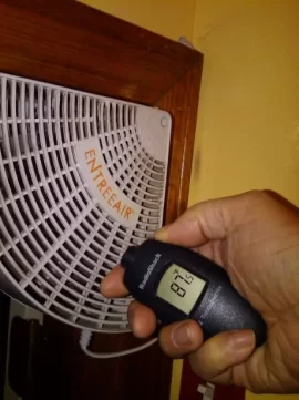

For curiosity I held a sound meter next to mine a few minutes ago. 62-64db one foot away with nothing else running nearby. Sure seems louder than that. When both the fan and the stove are running, the fan will drown out the stove. The fan has a unique midrange pitch to it.
