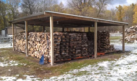

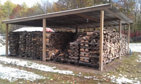

Finally done stacked up!

    Wow. Great setup. Nice stacks!

    Beyond Awesome! How many cords is that?!

    Woodshed itself can hold approx 14 cords. Current cords are 12.

    Nice simple design. Very functional. The wind will blow right through there.
    I like simplicity.

    I'm seeing zero cross bracing on that structure. Aren't you worried about it blowing over?

    Thanks for nice comments! Best investment I ever made! I don't stack up fresh split firewood in the woodshed, put them on pallets at open area in the back for approx 2 years then move them in the woodshed. I will post piles of fresh firewood soon.

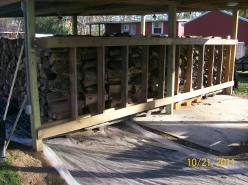

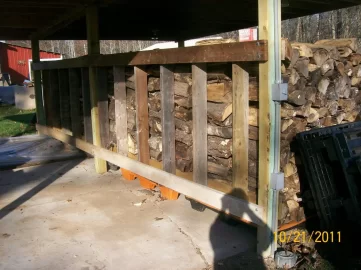

    I felt it dont need cuz 8 posts are 4x6 and four feet deep in the ground with poured cement. Only one middle post stand (free stand) on old cement slab. Also there is 2x6 brackets to support firewood at middle section (Run North and South). All screws (Lag, deck, and tin roof). I will try to find 2x6 brackets and post here.

    Here they are!
