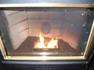

Well here is a shot of the stove after 8 hours of use. The door is completely sealed (very happy with the new one!) but unfortunately no change. Still enough ash that I need to clean out already as it starts falling into the pellet grate and affecting the burn quality.
The very small flame to me says too much air but the soot on the window and ash inside tells me not enough.
Has anyone been to this point where the ash build up is so much and discovered what worked? I notice most of the ash comes when the new pellets drop in. It tosses sometimes as much as 20-30 tiny pieces of buring ash into the air which approx 1/3 of it falls down to the sides.
The picture shows the ash build up after 8 hours as well as the fly ash from a pellet drop.. low light cause flash made the burning ash hard to see..
Thoughts?

You haven't seen real ash build up in a pellet stove.
What color is the deposit on the window and more importantly the color of the deposit on the firebox in back of the burn pot?
The ejecting embers look like you have some decent action taking place, it just needs to deposit the ash further from the burn pot.
The window has a brownish film with some black spots of ash stuck to it. Comes off quite easily mostly with vacuum and cloth or paper towel.
At current setting, the ash is actually quite a bit like salt & pepper. Some larger pepper corn size pieces, black and sprinkled through is a trace amount of white ash sparkled throughout.
On some lower air settings I had before, the ash was a very fine light powder and all black with maybe some trace of brown. Also, there is not much ash build up in the ash tray below the burn grate so it seems to be mostly flying out and not falling down..
I am thinking of closing the damper about a mm or two and reducing the feed rate by just a hair. I seem to get MUCH less fly ash with just a mm less damper but I think the pellets will take slightly longer to burn...
You are looking for light gray almost white ash, trim your feed just a tad using the feed trim control.

Just an update, I left for a couple hours and came back to the picture below ha ha.. when I looked inside the pellet grate was 3/4 full of pellets and restricting the air so the flame became lazier and of course more soot. I just adjusted down the feed rate a bit more and added just a VERY slight amount of air with the combustion air trim. I think I am getting closer...
  • Fine tuning.. problems finding the right mix of damper/combustion etc..
