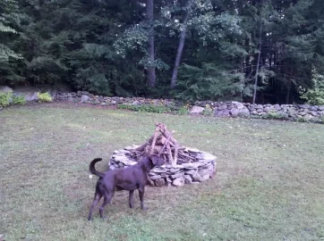

Small pit here when we moved in. I made it bigger. It's now 6' across, and I'd like to go bigger.
We just collected large stones from the nearby roads and plopped 'em down around the edge of the bowl I dug. One of the stones popped off a piece a couple years ago and fell into the pit. It's probably still there. The rest are fine.
I guess I could make it nicer, but don't need to. Plenty of guys/gals here have some very nice firepits.
