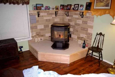

Well troops, the weather did get a lot colder and the house was 65 this morning with the prodigy on low .
Decided to fire the new stove up for it maiden burn.
All went well. A quick shot with the propane torch on a few pellets to get things up and going and it was off to the rodeo.
Here is a piccy with the little fire going
Snowy

Congratulations Snowy,
Nice looking hearth with stove and all in place. Great job.
Plenty of workspace around the stove... a wise feature for future cleaning.
Also, the relative long flue will enhance the overall efficiency of the stove. It's a heat exchanger in itself, with some extra cooling fins on the flue pipe perhaps the overall efficiency might even be enhanced further, but perhaps the flue can be cooled down too much leading to condensation. I have no idea.
My flue pipe is very short and I'm sure that too much heat is led out in the masonry chimney. Perhaps some cooling fins mounted on my flue might enhance efficiency?
Bo

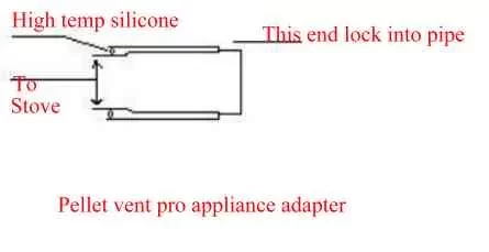

I refired the thing and turned the lights off, crawled under the pipe with a pocket sized LED flashlight and had a look see.
Both joints at the elbo to the straights showed wips of smoke and the appliance adapter which is inside the back cover was really leaking between the inner and outer layers.
OK I used high temp metal tape on the seams at the elbo and the pipe end of the adapter.
The area where the adapter goes onto the quick connector needed to be filled with silicone to be smoke tight.
Here is a sketch of the how to make it work.
The instructions did not say anything about filling that space with sealer.
WELL IT IS NOW and no more smell of smoke coming out of the beast either.

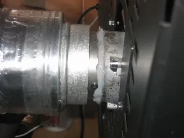

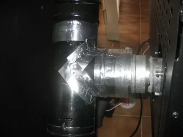

Snowy, this is what I did to eliminate some of the smoke. The rest of it was from the T....I ended-up wrapping all the T seams w/ aluminum furnace tape.....smoke problem gone.

Yup good old High performance furnace tape.
Iritates me that, I followed the directions supplied with the pipe and it leaked like a sieve.
Every 1/4 turn joint leaked as did the adapter.
The smoke was really leaking from between the inner and outer pipe at the appliance adapter.
If I ever do another one of these I will squirt the area in that adapter full of silicone before I assemble things.
Installed 3 self tapping screws through that stainless pipe and into the quick dosconnect collar to keep it tight even though it was sealed with High temp black.
I installed a 10-32 allen screw through the quick connector and into the exhaust fan outlet. The outlet and quick connector were a very snug slip fit ( very happy about that)
So all in all its good to go now.
