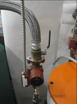

    I looked at a similar product to keep my 100 gal Smart (buffer) from being hard connected with black iron to the boilers. Ended up buying two 1 1/4" braided stainless flex pipes to keep the three heavys from pushing and pulling each other around. There not connected yet, but it looks like that will work ok, but again, they're (the piping) a bit pricey.

  12. Bob Rohr Minister of Fire
    joined: Jan 9, 2008
    565 posts
    SW Missouri
    If you use a rubber hose product, be sure it has an oxygen barrier of some sort. EVOH, aluminum, etc. Or you will get O2 ingress causing sludge and corrosion. I used the MetraFlex on mine just to try them out. They will build them to any size and fitting.

    Have those Ace Hose stalnless flex hoses connected and working on my Triangle Tube Smart 100 and earlier I said that they were 1/1/4", but they're actually 1/1/2". I didn't need to get them as long as I did to get the "flex" from them and they wouldn't have been so pricey. I see the Ace Hose 1/1/4" x 12" stainless and braided flex hose is $65 per. Here's the link
