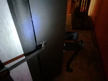

Is it just me or is the flue adjustment on the progress hybrid very vague?
The instructions give adjustments you should make when engaging the cat etc., but actually quantifying what is half open etc. is very hard since there is nothing to gauge the position of the arm against and it's all black so actually seeing the arm vs. the heat shield is hard to do.
I used a silver paint pen to paint part of the arm and make marks on the heat shield so that I have a point of reference as to what "half way" is but it seems like it should be a little easier, I've had to explain what the marks mean to my wife several times...
Anyone have a better system?
Thanks!
This picture shows my stove at "just under half" closed according to my marks...

I had to use a flashlight to take a picture of it since it's pretty dark back there even with the light on in the room.
It just seems like it should come with a mark on the arm and some sort of dial on the heat shield...

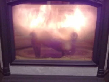

We happen to have an antique piece of furniture with a large mirror on top straight across from the stove, this is GREAT for adjusting the flame, just find the handle and look up in the mirror to see what the flames are doing.
