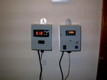

Another fan of the digital temp monitors, I put these together before the Auber ones were available.
One for flue temp and one for stove top temp.
As DougA says it make it much easier to run the stove, you can see exactly what the stove is doing.
When starting up I start closing the air control when the flue temp reaches 875::F.
You might be surprised just how fast the flue temp can rise to 1000::F( recommended high limit for class A) .
