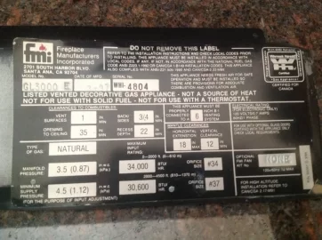

    Hi,

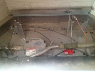

    My mother in law moved in to a new (older) home that has a gas fireplace dated from '97. It's wired to a switch on the wall and I never saw a pilot light, it looks like it has a an igniter and what I would call and electronic ignition (pilot less).
    When I first tried to fire it up it would click several times (presumably trying to light) and eventually would turn on...sometimes. It was the heat of the summer so we never let it run for very long. The clicking wasn't just the sounds of a sparker but also seems to rattle but I'm not sure of the normal ignition sounds. Now when I turn it on, it will click once...then nothing happens....then it shuts down and I can't get it to click again from the switch unless I wait several hours or days.
    I'm guessing it might be the ignition module and or igniter but I could use some help.
    Thanks,
    John

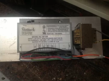

    I found a NOS Robertshaw Ignition Control Module on Ebay for $70. I installed it and it fired right up. No further problems. Check ebay.

    I had the metal info plate but my fireplace was so old it didn't matter much. I just got to the component level and used the part numbers off of that to do a search. In my case it was the grey box that was the Robertshaw module and the part number was the SP 745. From there I searched the internet.

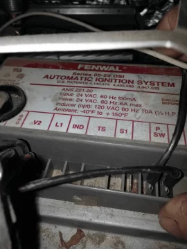

    This is what Ive come up with. I think I have seen a supersession to 35-605606-223 35-60 SERIES, 24 VOLT DIRECT SPARK IGNITION but not sure
