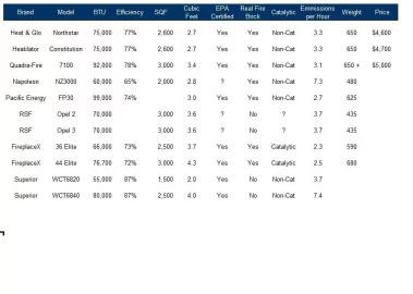

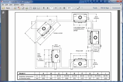

Have owned freestanding woodstoves (Hearthstone and Vermont Casting) and zero clearance flush mounted fireplace in previous homes. In a house without anything now but was interested in adding a new freestanding stove. Dealer brought up the concept of a zero clearance flush mounted wood stove "not fireplace" install. I am unsure of what the major differences in performance, output, efficiency etc. are between the two options.
Parameters:
1) Have a pre-existing outside foundation for a future chimney in place. Thus, could build external chase that would contain 2 flues (one from cellar and one from first floor) and a radon exhaust pipe from cellar to roof). Two story cape with walkout basement.
2) Could recess the first floor inside wall out into the chase (allowing for room for radon exhaust pipe and flue from the basement) to hold either a flush mount zero clearance or partially recessed (with regard to required clearances) freestanding wood burner.
The zero clearance flush mount would save space in the room but I am concerned about performance, efficiency, output, reliability, choices as I have no experience with these. Seems to me heat output /efficiency would suffer. The free standing is a known entity that I am familiar with but would take up space and make furniture placement challenging with required clearances due to a relatively small living room. Would need to use heat shields on stove and walls. House is 2000 sq feet so 40,000 btu would be plenty for 1st and second floors (main heat is propane hot water). The flue in the basment would be for future stove placed for ambiance, not neccesarily for heat.
I'm really am leaning to freestanding but if all the advantages of a freestanding stove were available in a flush mount, I'd consider one as the space saving would be ideal. If you'd advocate for a flush mount, may I ask for some recommended brands from forum members? Thanks for your help. Much appreciated.
Best, Pete
Parameters:
Best, Pete
