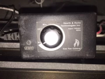

The blower for my gas fireplace is not working. If I press test button on gas fan control and hold, it operates correctly, until I release test button. Would that signify that gas fan control has failed?

Hearth & Home Technologies Inc.
Gas Fan Control
4021-229-B Rev A
120 VAC
60 Hz

If you have flame your fan is controlled by a heat controlled bi-metal switch inside your stove. look at your book you will find it no doubt it has gone bad! Easy fix also!Did you ever fix this issue? I am having the same problem.
its inside the stove I have one in mine for some reason I cant think of its name. here is the scheme your el for you stove fan goes to this when proper temperature is reached within your stove it makes contact allowing current to pass to your fan turning the fan on. none of your gas valve controls work the fan. look at the schematic drawing of your stove you will see it. very cheap and easy to put back in. on my Vermont castings stove I just lift the top panel of the stove and I can see it... if you don't have the book justI do not have a bimetal switch. I have the same set up as above. Would that be the thermopile or thermocoupler or the fan control switch?
Look for a snapdisc it just came to me. You should see it in your electricl circuit. it will show a cirlcle with 2 connections on it one in one out! sorry for the mental fade. they are very inexpensive i got mine off amazon! 15.00 i think.I do not have a bimetal switch. I have the same set up as above. Would that be the thermopile or thermocoupler or the fan control switch?
