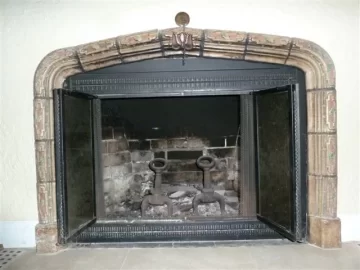

    I purchased a house last year that has a wood burning fireplace. I am researching what type of gas insert to purchase. The home is a 1929 English Tudor located in Portland, OR. Our winters are rainy but fairly mild. We have been down to the single digit temperatures during winter, but typically we are in the 20s – 30s during the nights in Dec/Jan/Feb.
    The room we want to heat is the living room. It is 15x20 with 20 foot ceilings. There is a large cathedral window on one wall, French doors leading outside on the another wall and two sets of windows across from the French doors. The windows are the original, leaded glass. The walls are plaster and the outside is stucco, I doubt there is much wall insulation. When the rest of the house is warm, the living room is chilly.
    The fireplace is in the living room. It is 40” wide and 30” tall. It is deep (but sooty so I didn’t measure).
    The fireplace is ornate with an arch around the fireplace opening. I need to put something in that is plain and doesn’t detract from or clash with the look of the original work.

    Here is the existing fireplace:

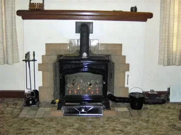

    You fire place is about the same as mine you have the same tile design and arch. English 1929 I did not change mine. Your room is about the same size as mine only difference is your ceilings are 20 feet mine are 8 feet. Do you have a ceiling fan? Heat goes up. I get a about 18 inches of cold air at floor level. I had to make my blower system to take care of that. Stove had no blowe option. Stove is made in Briton UK. My fire place was coal burner. I stuck my stove in front of fire place to save the tile work. Its a natural gas coal effect. Stove is 2,2500 in btu.s hi. low is 8,100 btu.s after high altitude deregulation it uses the euro modulating thermostat. room comes up to temp. flame starts coming down slowly back up if room gets cold. We get colder than you -15 some time average is 15 + It will keep room at 78-80 deg. Maxed out. Old brick house with single pane windows every 5 feet apart. I think like Dasky says go more btus always turn down or open doors to other romms. I also feel a ceiling fan will help a lot. I would have put a ceiling fan in but have 18 inches of blown in Celsius insolation in attic. Cant find 2x4 s to walk on.

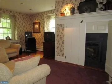

    I just moved into a house last fall with a Mendota Seabrook gas insert, which I was planning to remove and sell this spring/summer. We have free access to wood, and bottled gas is expensive for us, so we were planning on replacing this with a wood stove. I just popped in on the "It's a gas" forum to ask whether I should remove it prior to putting it on ebay, or if I should show it installed and working to potential buyers before I had it removed.
    In any case, Helen, if you're in the market for a Mendota Seabrook, I have one in good condition I'd like to sell. This insert is configurable for natural gas or LP, and is currently set up for LP gas. I'm not sure what is involved in converting back for use on natural gas, but I'm told it is not difficult or expensive to do so. It works nicely, with remote control, separate rear burner control, blower and damper controls, etc.
    I can get better photos if you're interested, but here's one the seller's realtor took for the house listing:
    Here's another I took the other night with my camera phone, while asking about wood stoves in another forum:
    Sorry about the poor photo quality (wasn't really taking photos with the intent of showing / selling this insert at the time), but I can get some nicer photos this weekend, if you're interested.

    There is no issue with the Mendota FV-44i pilot light. As far as radiant heat goes you can always turn the Mendota blowers off. You can never turn a Valor blower on. Mendota is all around a better built product.
  7. Ironhorse74 Member
    joined: Oct 24, 2009
    176 posts
    The Great Pacific North Wet
    One other thought. Mendota will build custom arched surrounds to match your fireplace. No sense trying to shovea square surround in an arched fireplace. They are even on sale through the end of October.
