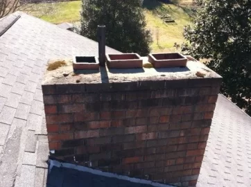

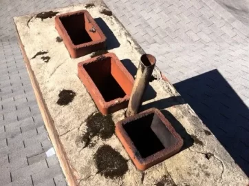

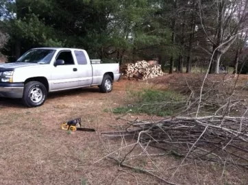

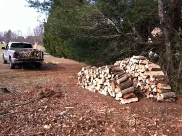

    photo.JPG photo1.JPG 111.JPG photo.JPG photo1.JPG 111.JPG photo.JPG photo1.JPG 111.JPG photo11.JPG photo.JPG photo1.JPG Never thought id get excited to get some cut up tree but hey, I guess Im getting old. Also, heres some pix of my chinmey. Some asked what liner I had so here ya go....

    new to the uploader, sorry for the double posting on the pix. And yes, the wood arrived before I could get down my sapplings, I ll restack later.

    Welcome to the club........what is the black chunks on top of your chimney, looks like chunks of creosote. You may want to give the flues a professional inspection to make sure they are not cracked inside. Also, if you plan on using wood to efficiently heat your home, maybe consider putting in a stainless insulated liner sometime down the road for added safety and efficiency.

    Welcome to the Hearth. take a snapshot down your chimney with the flash getting in there. Many here will have advice on cleaning and I will second having the chimney/flu looked at by a pro at least once before getting started. You are building a fire in your house so it is best to spend a few clams and be safe.

    Those chunks are actually moss on the chimney. The other stuff is black caulking for flashing on the bottom of the chimney. The smaller dark hole is the woodstove hole. This home was built in 1979 and the first fire to come from it ever was 3 days ago. Its never been used. I may do a stainless liner one day but there is no way that ill put one in just because its the latest in technology. My dad had a terracota insert in his when I was about 10. He fires it hard and has been every since. Had a chimney fire before then, never had a problem since. Im 40 now.

    Looks like you have a 7X7" flue for your stove. It's a bit large compared to the 6" circle required for your stove. But, you have a couple things going for you: a tall chimney and an interior chimney. FWIW, I use a 7X7" clay flue for my 6" outlet stove on my tall, interior chimney and it works fine.
    If your terracotta is in good shape there really is no reason to line it if you get adequate draft. I would focus on building your wood supply. In the meantime, you might want to buy or find just a bit of real dry wood to see if you can get your stove and flue temps up. That will help you to know what to expect performance wise once you have dry wood to burn.

    I would want a chimney cap to keep out rain, sleet, snow and meteorites.
    A screen to keep critters out is nice but I've had just a slab of cement resting on bricks before.

    Only thing I would do with that chimney is clean up that cement cap and give it a fresh slurry coat with some sort of acrylic-polymer modified cement to seal up the cracks. Once those cracks get started like that every time you get water or snow on there and water seeps into the cracks, and then you get a freeze thaw cycle, the expanding ice will open the crack a little more, eventually busting it apart and eroding the whole top and penetrating into the chimney.

    Going forward you're going to want to stack the wood on something other than the ground - pallets, cheap landscape timbers, scrounged 4x4's, or straight saplings.
    The termites will love the way that stuff is stacked currently
    Single row stacks in a windy/sunny area work best - appear you've got some sun there.
    I second patching the concrete crown - a little maintenance now will save bigger bills later
    The flue must have a cleanout door in the basement from your previous post?
    A sooteater or square brush will be in your future, while your wood is less than optimal it's a good idea to sweep every few weeks this season and next - until you have the operation down and dry wood

    Nice stack of firewood.
    Some pallets or poles to get it off the ground would help the bottom get air & season better ;)
