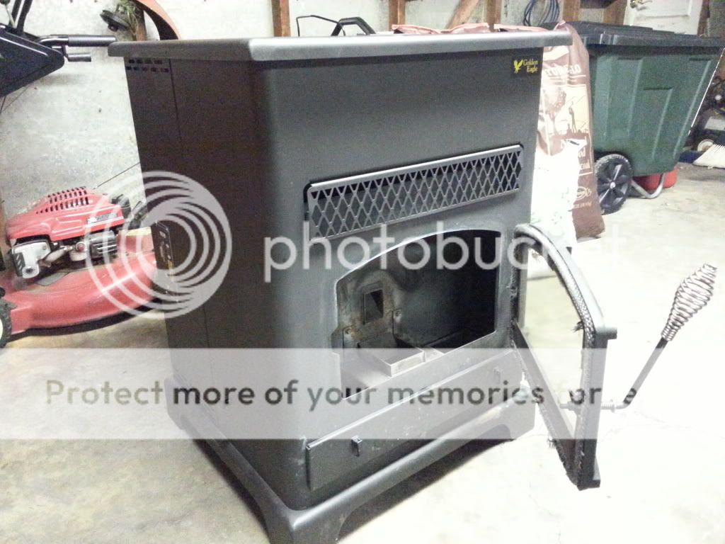

    I just purchased my first pellet stove for my garage. I don't know a lot about them other than what reading I did recently before this purchase. The stove is used. The seller said it was 2 years old. It appears to be in decent shape. I paid $400 for it with all the venting.
    I cleaned it out yesterday. Opened up the back and found a lot of pellet dust laying on the bottom. Piled up an inch deep in one spot. Vac'ed it out good. Should I be sealing the hopper better to prevent dust come out or is that just part of these stoves?
    The ash pan latches are crap. The guy I bought it from used a second gasket not glued on just to try to keep a tight seal. I think I will just get rid of the crapped latches and put something beefier on it and a new thicker gasket. Shouldn't be a big deal to fix.
    I read about a window air wash fix and a gasket for behind the burn pot. Anyone know more about those? Contact Golden Eagle?
    I'd like to get everything ready to install it this weekend. Any advise for first time install?
    How about pellets. I know nothing about them. Good or bad advice for pellets?
    Thanks in advance.

    Got the stove up and running yesterday. I noticed that if I run it on the higher settings (3-5) the burn pot slowly fills with pellets faster than it can burn them. That's with the damper all the way open. Is it due to the brand of pellets or just how this stove works?
    I have it in my uninsulated garage and it was only able to keep it about 60 with outside temps around 20. Garage is a 2+ car garage. Obviously insulation will help but does this sound normal? I had hope it would keep it warmer.

    I let it run for about 9 hours. I have the manual it came with. Not a lot of info in it. I dont see any way to make it burn the pellets faster? I only see a way to make them feed less to control the pot overflow.
    The latches on the ash pan are terrible. I put a new gasket on it but its likely not tight. Once I have a new latches installed I'll see if I can crank it up. Would a air leak by the ash pan cause the burn pot to overflow? Is so why?

    I welded up the top of the ash pan latch and put a couple weld beads on the bottom of it to make it a little tighter fit up and down. Latch can be tighten up now and seals off the pan well. I was able to run it on 5 (highest setting) for an hour last night without the burn pot overflowing. It was kicking out some heat. Took the garage from 42 to 60 in an hour.
    What am I looking for when adjusting the damper? Anything specific or does it just control how fast it burns the pellets?

    I put a fan blowing across the side of the stove to get some of the radiant heat off it. The sides get pretty hot!
    It actually runs great with the new gaskets and the latch fixed up. I can run it on setting 5 without issues. I think it just all the heat its got. How long it last who know?

    I'd agree with everything you said. I would not want to heat my home with this stove. While I seem to have it running good I only use it 5 hours a day and then it gets shut off. Not sure how long it would run if I left it going.
    The burn pot overflowing seems to be from air leaks in the ash pan. Once I welded the tabs on the latches and put on the thicker gasket it seals tight and the burnpot does not fill unless the damper is closed too much.
    I read someplace that these are not meant to run for more than a couple hours on setting 5 (highest setting). It doesn't say that anyplace in the manual. Anyone else read that?
