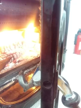

Same issue on my Quad. Freakin' nut on the handle is constantly backing off enough to allow the handle to spin 360 degrees when latching. It shouldn't do that. It needs just a little more room to add a jam nut but.....
Replace it with a new locknut. They wear out after a while. I prefer double nuts like regency uses over quads locknut's. But quads handles aren't long enough.
