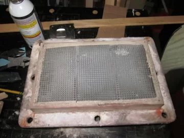

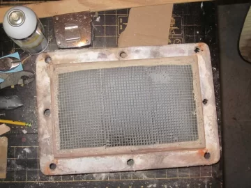

Indeed I did tonight. Used a dremel to cut the bolt on the left of the housing off and then went up through the nut cutting it in half. Used a couple wheels but was easy work. With the only one remaining being the one in the back, I was able to angle the cast housing down which allowed the existing bolt to bite enough to actually take it off with a ratchet set. Attached is a pic of the cat...looks like it needs to be replace.
Also, the heat shied bolts which go into the cast piece are completely frozen into the cast housing. No way to get them out except tapping them out...and since I do not have the tools to do that I would have to bring the housing to a shop (thinking at least $50). So, I am planning on buying a new cast housing ($90 from Buck) as well as a new heat shield ($30) and cat ($300). Yikes...this year this stove is running me a little money...
I am replacing the heat shield since it is warped.

BTW - you can can see on the left side of he cat there is a diagonal crack through the honeycomb. Another reason I figure I might as well replace the cat now that I have it all out. In fact, I would certainly need a new seal since the cat is pretty set into the housing and I am certain more will crumble when I try to get it out. As best I can tll...this cat is about 20 years old. It would last year, but was taking longer to light off. Once it did get going, it worked fine...I bet if I washed and soaked it, I could get a year or two more (assuming I could get it out) but since I am well past the normal life expectancy...I might as well do it all now...
Congrats on getting it out. That's a bit different in design than the 80. It has a deeper chamber that the cat fits into completely - flush with top of chamber. It only has 4 nuts to remove to get the chamber out and appears to have 1/3 less catalyst.
Is that damage to the cat in the upper right of the picture only on the face or does it go all the way through? If it's only on the face, the cat might still be usable. You probably wouldn't be able to move it to a new housing w/o further damage, but if you can free up the heat shield studs with penetrating oil and torch at least you wouldn't have to replace the housing

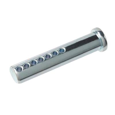

I wonder if you could cut off the existing, rusted on bolts and have a welding shop replace with something like this clevis pin? The multiple holes would give you adjustment as the heat shield warps a bit and you can use cotter pin and washer instead of a nut.
They should weld on a stop (a large nut would work) to give you the standoff room needed for the smoke to enter the cat (or you could just use another cotter pin to keep the shield from sliding up too far). If you can find it in SS, it should last indefinitely. Even mild steel should last a long time.
