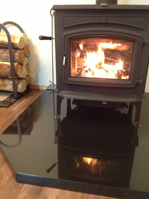

    Ok uploading the photos:
    As delivered, It has a three inch perimeter and the pads are 4X4
    [IMG]
    First layer of Micore 300 is in. Not shown is the adhesive mentioned above by Scotty however that is what I used
    [IMG]
    The second layer is 1/4 inch Hardi backer cement board:
    [IMG]
    The last layer is another of Micore 300
    [IMG]
    Felt pads brought everything to the same level
    [IMG]
    Flipped over:
    [IMG]
    Heavy lift :
    [IMG]
    I still need to re install the ash lip and the rear heat shield.
    [IMG]

    Thanks for the replies guys. This thing is heavy so I had a friend help me flip it over onto some pine boards, after that I used a wonderbar to get it down to the floor level. There is a knee wall directly under the stove (near dead center of the span) so I went below and beefed up the studs around where the stove/ hearth sit.
    The construction adhesive was really just to hold it all together while it was being flipped over/ positioned.
    I cant use the stove just yet as the rear heat shield is off still and I plan on installing some copper sheet metal squares under each leg to break up the black a bit. I also noticed the legs recieved a very poor paint job at the factory so when I install the copper squares I will touch up the legs
    Yes Absolute Black. the stove is in the dining area so I matched the counters in the kitchen
    Again thanks for all the help and compliments. It was knowledge of this forum that helped me greatly

    [IMG][IMG][IMG]
    A few updated pics
    Copper plates under the legs:
    [IMG]
    Dinning room with guest appearance by Kayden (my son) :cool:[IMG]
    [IMG]
