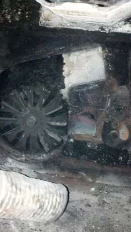

I get a service call request for some creosote build up and a report the stove "just stopped working, last season". I go over and this is what I find. You be the tech and tell me the problem, hint there is a picture so it kinda directs you where to look (it is not a hopper issue).

How could any stove get that bad, oh, I see a Harman.

One word......WOW
Clean the ESP and it will start right up.
That whole air flow thing might be an issue but yes the esp and airflow makes the stove happy.

Too much fuel for the air flow provided.
Soot will start reducing the airflow as soon as a fire starts burning, once the airflow/fuel mixture can't be adjusted to compensate the stove starts producing creosote.
Since in a Harman the ESP controls the feed and air flow after awhile the soot on the esp all by itself can cause the stove to burn funny but the problem doesn't have to start with what is in the exhaust path it can start anyplace there is a gasket that is worn or if the door is not shutting tightly.
All pellet stoves (not just Harmans[one must keep Defiant happy]) will do this once the air fuel mixture gets out of whack.

Was that just the outlet or was the whole vent (at least any horizontal) plugged too? I wonder how many tons it takes to get like that. One ton through mine and it only builds up about 1/8" on the vent and outlet sides.

so by never cleaning the ESP it caused that stove to do that? Do I understand that correctly?
That could have been but one possible cause, but that is not what I'm saying.
What I'm saying is that that black crap is caused by too much fuel for the combustion air available and that can be caused by a number of things not all of which are at the back end of the burn process.

I could be wrong but that stove looks like it hadn't been cleaned in a very long time...meaning more than one season. It doesn't appear to be a airflow issue to me...just an extreme lack of maintenance. As you say, Harmans automatically adjust the airflow. I never have any creosote in that part of my P61A, just fly ash.
X2. I burn close to 5 tons a year, and it would take multiple years to get mine looking that bad.
