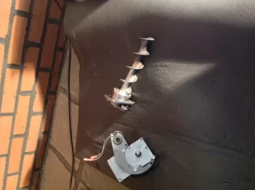

    GOT HOME YESTERDAY AND STOVE WAS NOT RUNNING. HOPPER FULL OF PELLETS. CLEANED STOVE. CLEANED ESP PROBE WITH A SOFT BRUSH. NO BUILD-UP IN FLUE PIPE. ALL OTHER MOTORS OPERATE CORRECTLY. AFTER TAPPING ON AUGER FROM THE FRONT OF THE STOVE IT WOULD SPIN A LITTLE THEN STOP. ALL DOORS ARE CLOSED WHEN TRYING TO FIRE AND GASKETS LOOK GOOD. I PULLED THE AUGER ASSEMBLY OUT TO MAKE SURE NOTHING WAS STUCK IN THE AUGER TUBE, DID NOT SEE ANYTHING. THIS MORNING I AGAIN PULLED THE AUGER ASSEMBLY OUT AND I AM NOT ABLE TO SPIN THE AUGER AT ALL BY HAND! IM ASSUMING THE MOTOR IS BAD BUT NOT 100%. THE FEED MOTOR LIGHT DOES LIGHT UP ON THE BOARD SHOWING IT IS TRYING TO SPIN. THE BOLT ON THE AUGER SHAFT IS TIGHT.
    ANY ADVICE WOULD BE GREATLY APPRECIATED!!

    First, take the Caps Lock off. No need to yell. Second, disconnect the auger from the motor & hot wire the motor to a wall outlet. That will tell you if the motor has seized or failed...

    Haha sorry DAKSY. I Plugged the motor into an outlet and the shaft does not spin but I feel the motor vibrating like it's trying to run.

    Did you loosen the screw to disconnect the motor from the auger?

    If the motor doesn't turn, I'd say that's the problem. At 3 months old, it's still under warranty, I believe...
