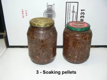

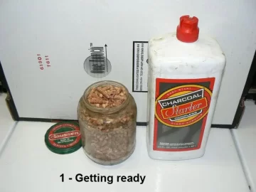

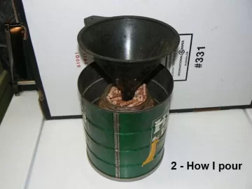

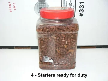

I have a 1994 Breckwell P24 insert that is also a manual light stove. What I do is make my own starter pellets. I don’t know if this will work for your Harmon but I will through it out there for you to decide. I have been doing this for more than 15 years.
I fill a 32oz glass jar with pellets. I actually use more than one jar.
I fill the jar of pellets with charcoal lighter fluid and seal it.
Let the jar sit long enough for the pellets to soak up the lighter fluid. (days?, week?)
When the jar has sat long enough fill up another jar with pellets.
I place the second jar in a larger container, coffee can.
Use a funnel and pour the fluid from the first jar into the second jar.
The larger container is used to catch any spillage.
Top off the second jar with lighter fluid. Seal it and let it sit until needed.
Put the soaked (starter) pellets from the first jar into a sealable container of your choice.
To start my stove:
I fill the burn pot about half way full of dry pellets.
I sprinkle some starter pellets on top of the dry pellets and even them out.
I open my damper and light the starter pellets keeping the door ajar, not closed.
I let the pellets burn for about 1-2 minutes so they get red.
I then turn my stove on so the combustion blower will start up.
This helps the pellets burn better.
I let the pellets burn for another 1-2 minutes with the door still ajar.
When I see a good flame I close the door, adjust my damper and start the auger.
I manually feed a few pellets.
I’m good to go.
Suggestions:
Don’t be impatient (like my wife) and not give the starter pellets enough time to burn.
Don’t be cheap (like me) and not put enough starter pellets in the pot to begin with.
