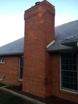

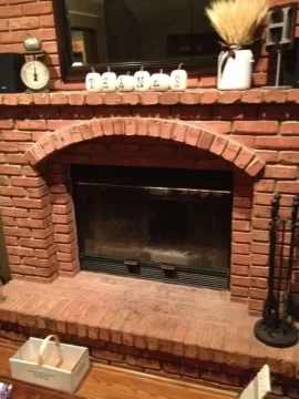

    So the thread title explains my situation pretty well. My house was built in the early nineties and has a full brick exterior and a pre-fabricated fireplace with brick surround / framed chimney in the interior. Of course, the pre-fab is extremely inefficient and I feel it's almost wasteful to burn my white oak and hickory firewood in that thing.
    Plain and simple, what are my options regarding the installation of a woodburning insert? Because I do not have a masonry chimney, does that eliminate the option of installing an insert? Any advice would be much appreciated!
    I've attached a few pictures of the pre-fab and my brick exterior.

    You have at least one option, that is a free standing stove vented into your existing chimney with a fully insulated liner & a new cap. I realize that may not be the MOST desirable option, & it will require additional hearth protection & maybe some sheet metal to cover the existing opening. There is a possibility of installing an insert, but you will have to see what will fit in the existing opening. An insert will also require an insulated liner & additional hearth protection, but it will look better. Many units from the early 90s didn't consider insert change-overs & the manuals didn't include the instructions on how to do so, but yours may be different. Your best bet is to see if you can get measurements & pix of the insides & talk to your local hearth shop...

    For an insert installation most likely the prefab would need to remain in place. It can't be installed in the cavity that would remain with it removed because the prefab acts as shielding to the nearby framing of the fireplace. There might be other options, but they probably would require more serious reconstruction. If you are willing to go that route then replacing the current prefab with a modern EPA ZC fireplace is also an option that would make a significant difference. Note that this is not an insert, it is a replacement fireplace that would require opening up the exterior side for removal and replacement.
    The freestanding stove option should have a block off plate at the damper level or lower. You don't want to be heating up all that exterior masonry. It represents a significant heat loss.

    I appreciate the feedback. The current opening / size of the pre-fab is approximately 42 1/2" wide and 32" tall. Are there any EPA zero clearance fireplaces that come close to being able to use the existing opening? I'd like to keep the brick work intact if at all possible.
    When I say "come close to being able to use the existing opening" - based on my limited searches, it appears that this is too small for EPA ZCs.
    Are there any stoves that would work with this opening?

    Putting an insert in the pre-fab could be problematic with regards to UL listings, codes, and insurance companies. The prefab may also not be designed to support the weight of an insert. If you do put an insert into the prefab, make sure that you talk to the manufacturer of both and make sure that the particular combination that you're looking at is approved.
    My suggestion would be to look at removing the prefab unit and replacing it with a ZC (zero clearance) stove. The ZC units are made to go directly into framed openings like you have. You'll get the efficiency of a stove with the look of a built in fireplace, and you'll be sure that your system is installed 100% correctly.

    The problem is not the opening, per se. it is the entire size of the ZC fireplace. What you can see there - 42.5 wide & 32 tall is the "tip of the Iceberg" so to speak. The box that's framed within your wall is probably 54 - 60" wide & 40 - 48" tall. The chimney that runs up inside your bricked chase is not going to be compatible with the newer EPA rated fire places, so that will have to come out as well. Your decision is going to be what part of your house are you going to destroy/rebuild (Inside or Outside) in order to get the old one out & the new one in. Good masons can rebuild your structure so that it looks almost original, but there's no easy way to do what you want.

    I had some time this evening to visit a local fireplace dealer and I explained my situation to the salesman. I noted that I had a pre-fab / builder box fireplace but wanted some more efficiency / wood heating. I showed him some pictures and he immediately recommended installing a Quadrafire 2700i in the pre-fab (in lieu of ripping it out to install a zero clearance high efficiency model). He was extremely confident in this fix. I have a Marco pre-fab. Can anyone confirm that he wasn't just blowing smoke? Does this sound like a good / save setup with the Marco? Any feedback on the 2700i? Thank you in advance!!!!

    I would still talk to Quadrafire and the manufacturer of your prefab to make sure they are a blessed combination. If they are not, and you happen to have a problem (heaven forbid), your insurance company might use that as an out to not cover the loss. They might catch it ahead of time and cancel the policy if it doesnt pass inspection due to improper installation.
