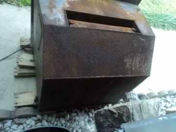

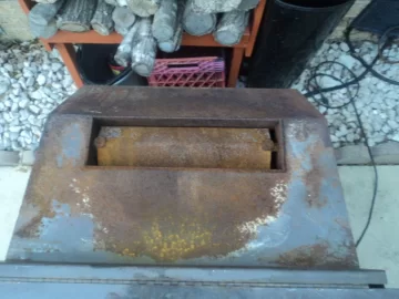

What do I want to gain from posting this if I have these ideas? Well on the second portion, how does the boot get put atop the fireplace? I have hardly any room once the fireplace is inserted. So I think if I put the adapter atop the fireplace and tried to shove it in - no go. I would have to shove it and have someone hold it, shove the fireplace insert in, then set it atop with adhesive or possibly try and drill/mount it? That is my dilemma. I live in Central Texas but I can't figure the $2500 price tag quote I got to install. I'm only seeing less than $500 materials (minus the cost of the stove). Pictures attached below of the way my fireplace top is. I think I would need an adapter at the end of the pipe to the boot to insert? What would that be called? I'm a DIY guy but this sort of stuff is a new world to me and I want it to be to code - just incase - things happen and plan to have it inspected upon finalizing the installation for that reason.
