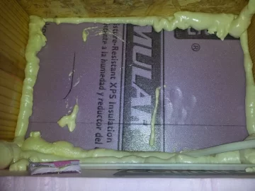

As someone who installed an EPA stove in the basement last year, I typically saw basement temps of ~64-68 degrees. 68 when the stove was giving it's best. Basement had very little insulation, R-5 on about half of the walls. Now I have it completely insulated to R-5 and in the process of insulating to R-10. More importantly, I used 2-inch XPS cut and placed in the rim joist, sealed in place with Great Stuff can foam. Since I closed up a lot of those air leaks, I installed an OAK (running up the wall through the rim joist) and that helped a ton to reduce air infiltration.
My basement is typically 68-72 degrees now, and I think it'll get better as I get the insulation completely up to R-10. Based on the dimensions in your drawing, 2 inch XPS foam board (R-10) would be ~$1,125 based on ~$25/ 4'x8' sheet (45 sheets) plus your local tax & foam adhesive. Just a thought to compare to the cost of an add on furnace.
One last thing, XPS should be covered with a fire-retardant material per code (I think IRC) so eventually you would need to cover it with 1/2" drywall or something similar.

The fiberglass batts are definitely less expensive, but I really would not recommend them in a basement. For one, fiberglass batts are not an air barrier and therefore would need to be enclosed (on all 6 sides, left, right, front, back, top & bottom) so no air passes through them. If air is passing through them, the R-value is reduced and can become essentially R-0. Not a problem if you frame, insulate with batts then cover with an air barrier (like drywall), but now the cost is going up...along with time and effort. IN other words, you won't get that R-value until your basement is finished. They also will most likely end up with mold growth in a basement, especially more likely in a warm basement with a wood stove. Here is a good link that describes it. That is why I think the 2" XPS will give the most bang in the short-term and long-term.
(broken link removed to http://www.buildingscience.com/documents/reports/rr-0202-basement-insulation-systems)
I may be able to do one better. Attached is a pic of what I did. I used 2-inch because it has the highest R-value and because you need at least 1.5 inches of XPS for a moisture barrier (to reduce the likelihood of mold formation). Again, this is why I felt I needed to do the OAK. I really eliminated a lot of air infiltration and since my stove is in the basement, I was afraid it might starve for combustion air. Since that air is not coming in through those cracks anymore, the basement has MUCH less of a "chill" factor. In fact, my wife just headed down to the basement to hang up laundry and said "I'm going downstairs where it's warm." Keep in mind it is not finished, just insulated to R-5 at the moment.
