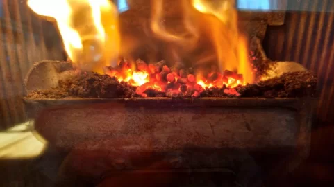

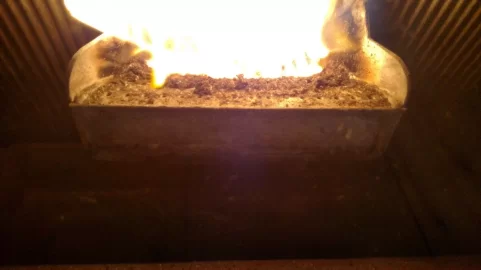

Replaced the gasket today and am waiting for the silicone to dry before firing it back up. Also ran the brush through the tubes a couple times pulling a considerable amount of buildup out.
The stove wouldn't just burn what was left in the burn pot when shut off, it would burn until the hopper was empty. That problem has been resolved with the new control board.
I was getting a lot of soot on the door, enough to have to clean it every time i would scrape the pot
These are before and after a good cleaning and a new door gasket after 8 hours of running. I had to put a snake through the vent on the left to get around the back and through a blockage....hooked the loop on the brush to the snake and pulled it back through the cleanout door and through the vent chamber backwards.... Happy stove so far. Thanks for all the advice and quick responses.

Love it when a plan comes together and now you know more about your stove than you did before. Great forum, isn't it?
Lot more air going to the fire as it should and not around:)
