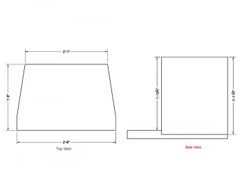

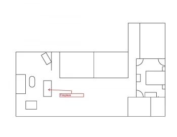

I'm closing on my first house. It's a 1700sqft single story home with an interior heatform fireplace. Dimensions of fireplace and house layout are attached below. Climate is coastal northern ca. (30*F in the winter). I was set on the Osburn 2000 until I measured the fireplace. The brick hearth is 1.25" above the inside of the chimney, which makes the osburn unit a little too tall. (i think). I like the look of the Regency I2400 and the price point of the Osburn. I can't find the Regency online anywhere and the local dealer wants $3200 for one.

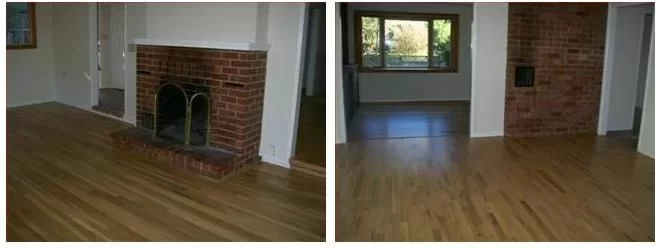

These are the only pics i have of the fireplace. The height of the opening seems to be the main issue. At only 22.5" tall many of the inserts aren't fitting. I'm checking into the units suggested so far. I appreciate the advice.

I have a similar set up. I am assuming that the opening of the fireplace is facing the smaller area to the left?
May I suggest a free standing stove, then, against the back of the FP, facing the area to the right side of your diagram?
It will be also easier to move heat through the house. Those doorways can be tricky, if an insert is used.

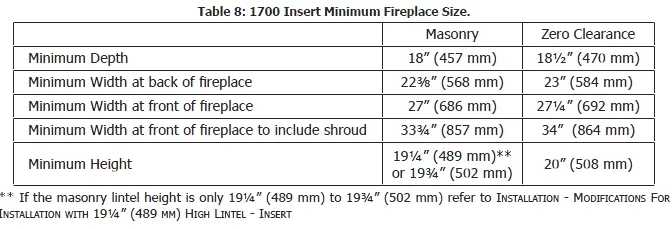

Check out the Enviro Kodiak 1700. It is only 19" tall.

I think I have it narrowed down to either:
Napoleon 1402
VistaFlame VF1700 (same as enviro kodiak 1700?)
I've decided the vistaflame VF1700 insert looks like the way to go. I finally got moved in and measured the chimney tiles. The inside measurments are 6" x 15" oval. What is the best way to attack this with a liner/insullation.
