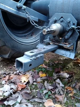

I went to tractor supply and purchased a build your own hitch receiver tube ($20). I welded that to my draw bar and can now insert ANYTHING that would go into the hitch of my truck onto my tractor as well. Just like removing something from the receiver in your truck, all you have to do is pull the pin and slide it out.
That was my solution.
Here is a picture of what I did. Purchased a 2" receiver tube and welded it to the bottom of my drawbar (or top if you prefer). Now I can use a tri-ball, drop hitch, or any other attachment that works with my truck hitch.

How are you going use it as a regular drawbar now, buy or make another drawbar?
All I have ever used that drawbar for is pulling around a little trailer. Like this I can take the tri-ball from my truck and voila!!
Maybe I haven't used it enough to know what else I should use it for. What else would I use it for?
I would never put one that short because it's going to hit your tires and you can't turn very sharp.Curt15
